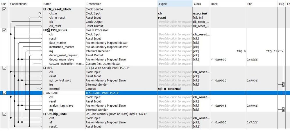

You can create a basic NIOS2 - SPI system like the one shown and then export the SPI interface externally and connect it to the ADC board.
- TFern4
Do you know what is the commands to write/read using the SPI (3 Wire Serial) Core? Would be IOWR(SPI_BASE, ... ) and IORD(SPI_BASE, ... )? Thanks.
