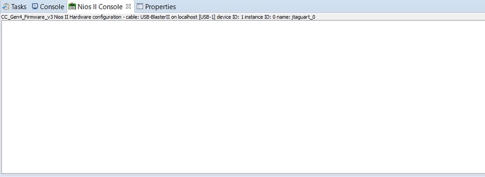

    I'm sure the issue is not with the code. Just a while ago, the code was working fine, and when I run it again, the Nios output console is not displaying anything now.
    Later, I tired creating another Nios II application in Eclipse to have just the Hello_World template. Still the same.

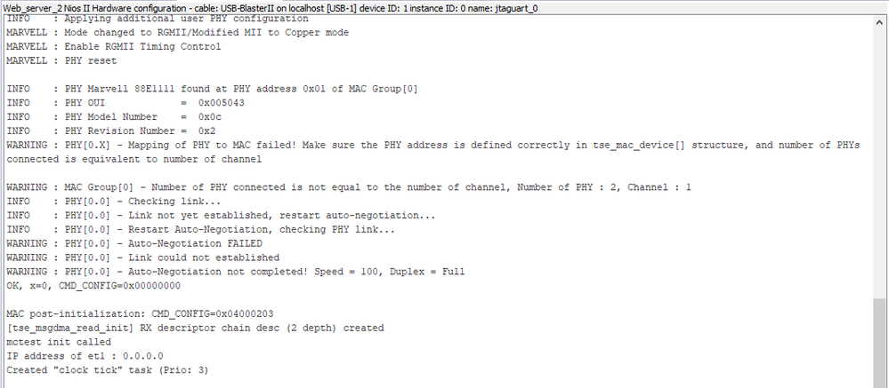

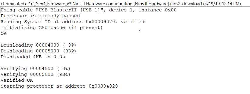

      I'm sorry I attached wrong snipshots in the previous reply. Please look at the attached images
