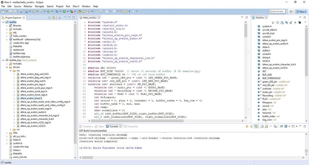

I have used nios2_system.sopcinfo file from project and created a new eclipse project with name testlite and successfully generated elf without any error.
- Delete your software folder and recreate the eclipse project by importing .sopcinfo file.
- or import the software file attached.
