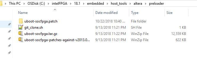

Is there support for Cyclone V with EDS 18.1?
I just installed SoC EDS Pro 18.1 and the \embedded\host_tools\altera\preloaders directory is missing.
Also, when I run bsp-editor, I only see support for the Aria 10 (uboot and UEFI) but not the Cyclone V (or anything else).
I see nothing that says 18.1 doesn't support Cyclone V parts. Does it? Do I need to keep using 18.0?
If it should support Cyclone V parts, how do I get that working?
  • FawazJ_Altera's avatar
    FawazJ_Altera
    I think you are referring to the pro version of SOC EDS.
    The std version of SOC EDS is supporting Cyclone V, Arria V and Arria 10.
    Here is the content of my installed SoC EDS.
    Hope this might help
  • Dzar's avatar
    Dzar
    Ah,
    so I need to download/install standard, not Pro. Silly...
