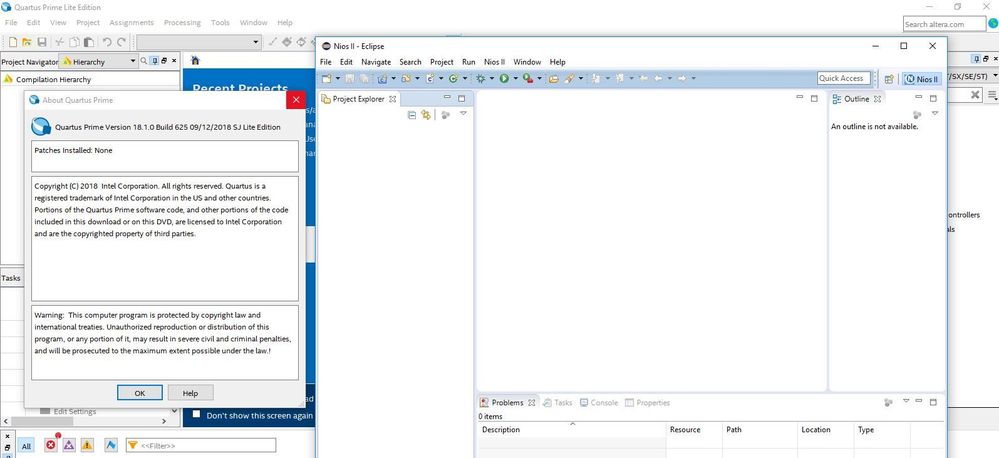

I'm using Quartus lite 18.1 in windows 10.
We can successfully launch eclipse without any error.
Anand Raj Shankar
