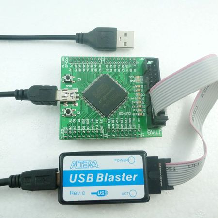

I want to add and correct some details of the behavior described above.
As far as I can see:
-The RS-232 terminal that is receiving all the messages coming out form the UART through the "imprimir" (print) function, are "T1" , "T2", "T1", "T2", so I understand that the system is inside that loop at a high speed, ignoring the vTakDelay and the delay functions.
-The 0x80 LED is on, so the interrupts are disabled
-The 0x01 and 0x02 LED's are both on at the same time, ignoring the blinking I was trying to produce with the delays functions
-The 0x04 LED is constant on too, so I can tell that the TIckHook is at least executed once, but it is not blinking, so I think the system never calls this interrupt again.
I do not understand why the program keeps ignoring both delays, the delay function and vTaskDelay.
