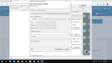

Hello everybody! I need help "error: no BSP found" when i tried to create NIOS II Board Support Package by Nios II 12.1 Software Build Tools for Eclipse. Can you help me, please. Thank so much! ...

I think you have not loaded the .sopcinfo file generated by your qsys/platform designer correctly.
After giving the .sopcinfo file we should see the CPU name,BSP type BSP version and command
Kindly reload the .sopcinfo file and check.
If possible attache the .sopcinfo file.

7 years agoThank you for your help. I restored my windows. And fortunately, my .sopcinfo file is work. I think my windows is error.
