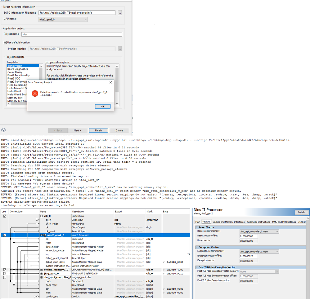

Error creating Project with custom component as reset and exception vector.
I get the following error when creating a new NIOSII application and BSP from Template with a custom component as reset and exception vector for my NIOS/f cpu. See the attached picture for details.
Where my zim_qspi_controller components interfaces are set generic.
The generics are generated with the _hw.tcl scipt.
In the component the master communicates with a dual port fifo over the avs_mem interface.

I am using:
Platform Designer 18.1 Build 625
NIOSII EDS 18.0.0.v20180425- 1

    After reading this post, I saw that I haven't checked the: isMemoryDevice in the _hw.tcl file.
