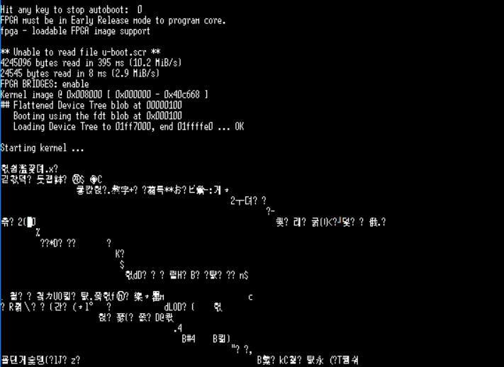

Can someone tell me how can I solve Linux porting problem?
I am trying to insert Linux img into ARM using a SD card.
but, there is a serious error.
after kernel start, characters break out.
I used Arria10_Linux_SDCard img from quartus 17.1 SoCEDS.
Thanks for help.
- Daixiwen
Is this the console on a serial port? It looks like the Linux image itself is setting the serial port at a different speed than uboot used.
- KCho1
Dear Daixiwen, Thanks for the advice. yes This is Tera Term console on a serial port. I tried changing the baud rate setting within Tera Term, but It is the same.. and I also changed the language to UTF-8 and it's the same...
My device name is 10AS027E4F29E3SG.
Is there another way to change the speed of serial communication?
