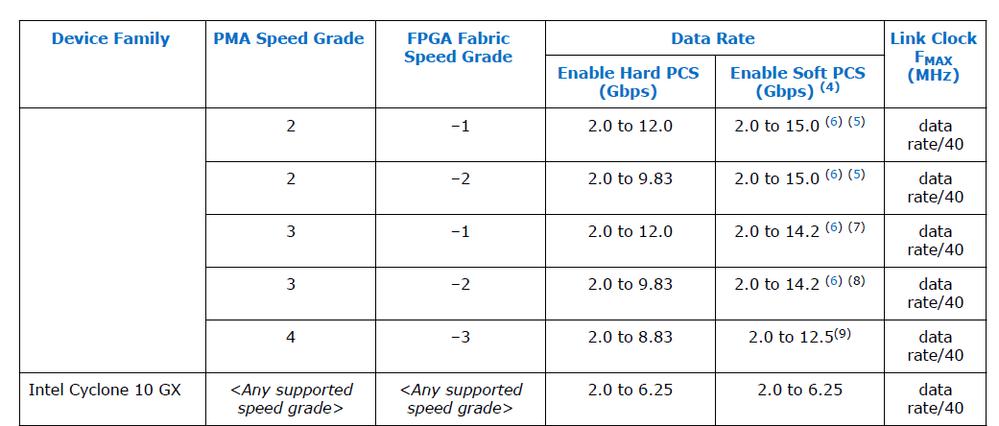

Why the maximum speed about JESD204B in Cyclone 10 GX is only 6.25Gbps
Cyclone 10 GX serdes supports up to 12.5Gbps,what's the reason limits the speed​?Thanks

    As I understand it, you have inquiries related to the max speed supported by JESD204B IP in C10GX devices. As I understand it from Factory previously, the 6.25Gbps seems to be the design target for C10GX devices and Engineering has validated the IP up to this data rate.
