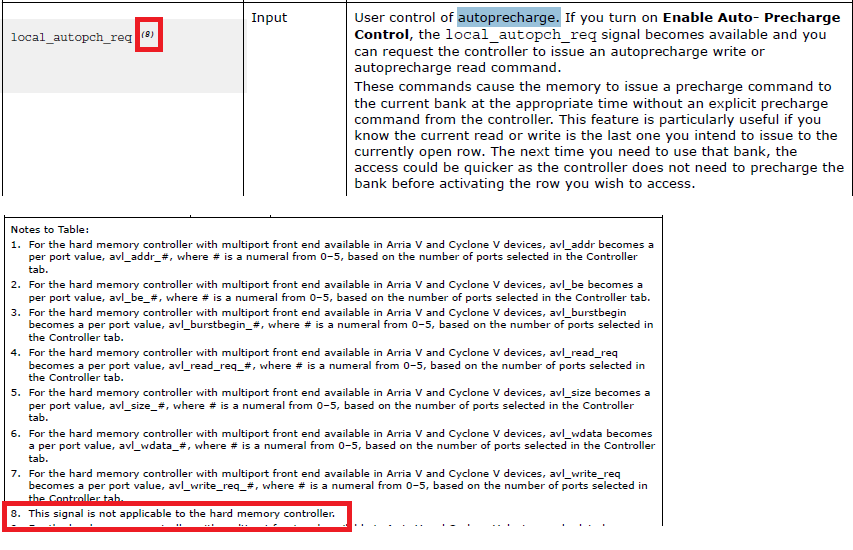

7 years agoWhy does the auto precharge input signal disappear in Qsys for the DDR3 memory controller IP block when Hard Memory Interface is enabled?
The enable Auto-Precharge Control option remains selected, but if you change between not using the Hard interface to using it, the signal is no longer present in Qsys. This is targeting a Cyclone V SoC, IP is the DDR3 SDRAM Controller with UniPHY Intel PFGA IP.

Hi JWils26,
Unfortunately hard memory controller doesn't support auto-precharge control and won't enable "local_autopch_req" as shown in attachment.
You can consider to use regular soft memory controller that support auto-precharge control (uncheck hard memory interface) option in DDR3 UNIPHY IP.
I am really sorry for any inconvenience cause.
