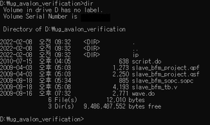

(open "slave_bfm_sopc.sopc" files, there nothings..)
as u can see slave_bfm_sopc.sopc files..
only figure out some clue..
- clk_0 = 50Mhz
- device : STRATIXII
- Software : Quartus 9.1 Version
- Project Name(file) : slave_bfm_project.qpf
output files : Verilog
