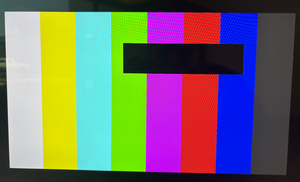

- I adjusted the red gain via a color space converter and the ROI region remained black while the color bars changed.
- When I attempt to use larger ROI values typically the function call to intel_vvp_tmo_set_roi_horizontal_x0x1 or intel_vvp_tmo_set_roi_vertical_y0y1 will hang the nios2 processor. On one attempt I was able to set vertical 0->1060 and horizontal to 0->1900. The black area still appeared with a small bit of the test pattern visible.
- I also happened to try a 800x800 camera feed and the results were the same.
Color Bar with Red Gain Set to ~8x:

If I set the resolution with intel_vvp_tmo_set_resolution and then try to exit bypass mode the component stops producing frames. In ROI mode, the component still produces frames but shows the black box as described above.

If I don't use ROI mode I don't see a black box. However, I expect in non-ROI mode for the component to function and not freeze the video pipeline when leaving bypass mode. I don't know what you mean by not using the "default settings". I am following the example from the documentation which clearly sets the resolution with intel_vvp_tmo_set_resolution:
By "default" this design does not perform its intended functionality regardless of resolution in ROI or non-ROI mode.
