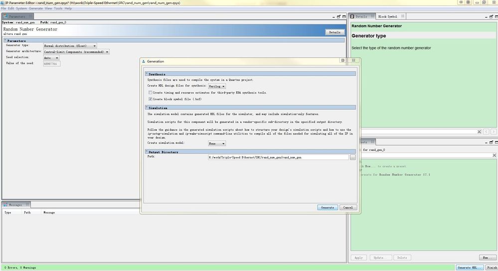

There will be some errors when using the 17.1 standard version to Creat a Random Number Generation IP
I ran into a difficult problem. When using the 17.1 standard version to create a random number IP, an error will be reported, see the text and the attachments.
I am very anxious and look forward to your reply, thank you.

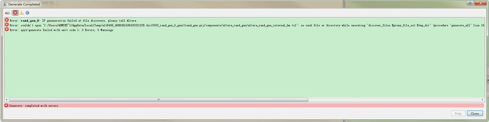

Error: rand_gen_0: IP geneneration failed at file discovery, please tell Altera
Error: couldn't open "C:/Users/ADMINI~1/AppData/Local/Temp/alt8408_4688452438430321239.dir/0002_rand_gen_0_gen//rand_gen.prj/components/altera_rand_gen/altera_rand_gen_internal_hw.tcl": no such file or directory
while executing
"discover_files $proxy_file_set $tmp_dir"
(procedure "generate_all" line 16)
invoked from within
"generate_all $output_name QUARTUS_SYNTH"
(procedure "generate_quartus_synth" line 2)
invoked from within
"generate_quartus_synth rand_num_gen_rand_gen_0"
Error: qsys-generate failed with exit code 1: 2 Errors, 0 Warnings
  • KennyT_altera's avatar
    KennyT_altera
    This issue seems to be fixed in the latest release of Quartus Prime 19.1std version. can you try using the latest version?
