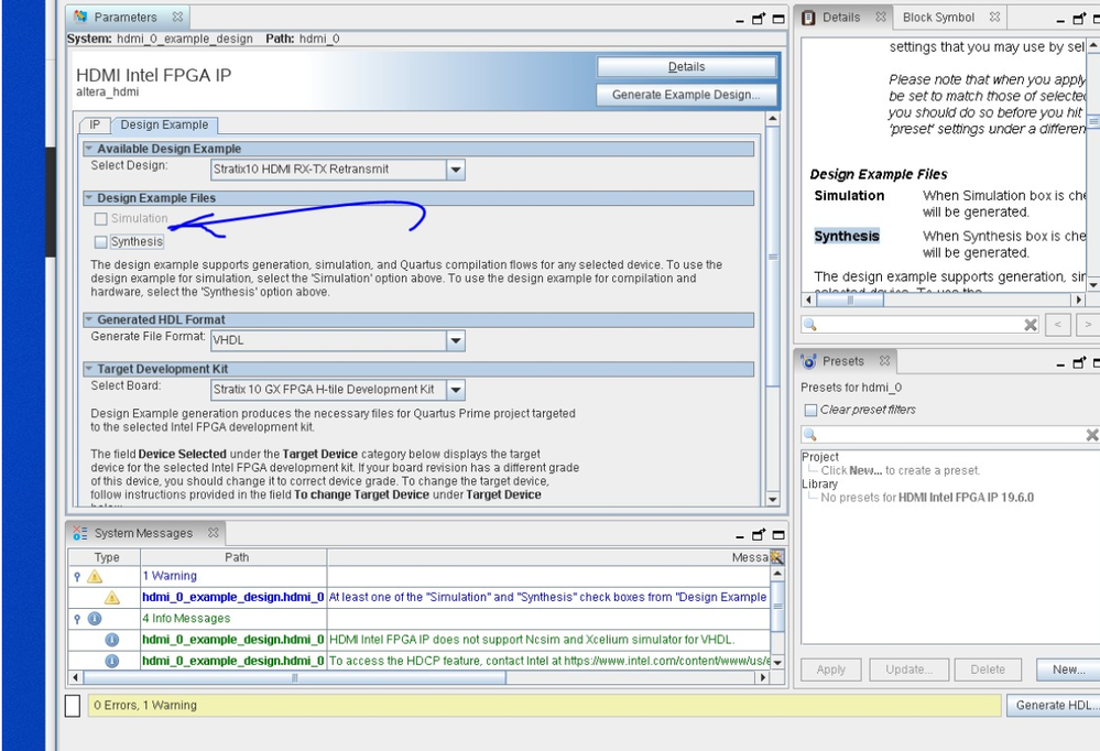

I am trying to generate a design simulation for Stratix10 HDMI example design in Quartus but this option is blocked. I am using -
Can you assist with this issue...?
- BoonT_Intel
Hello Sir,
The reason is that simulation does not support I2C i/f. Go to the "IP" tab, scroll down and untick "Include I2C master/slave" then you will see the simulation box is visible.
- Yossi1
It's working....!!
Thank you!!!
