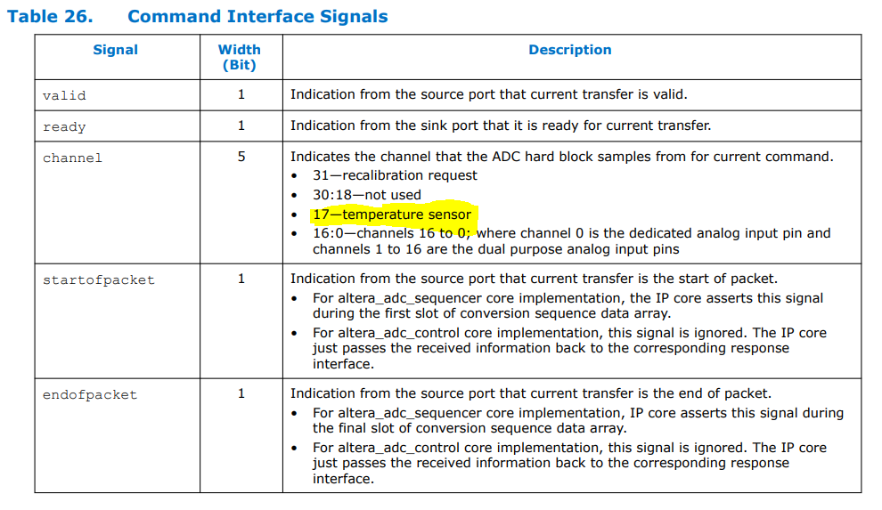

(b) What is the ADC Control Core channel code for COMMAND_CHANNEL to read the TSD?

2) the command_channel for TSD is channel 17. See https://www.intel.com/content/dam/www/programmable/us/en/pdfs/literature/hb/max-10/ug_m10_adc.pdf (Table 26)
