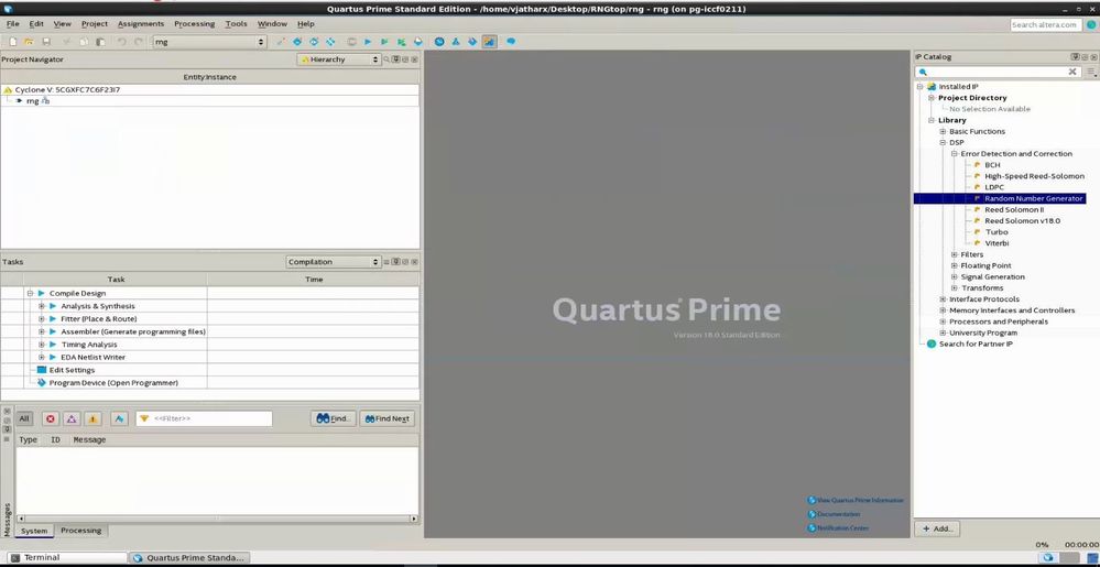

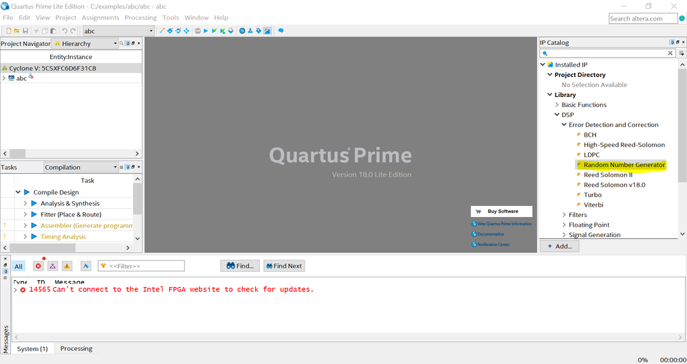

  • Vicky1's avatar
    Vicky1
    Hi Vinay,
    Please open project with proper device from Cyclone V family & then check for IP.
    Yes, you can upgrade to 18.0 & higher version too.
    Please find the screenshots & let me know if you have any concern.
    -Thanks,
    Vikas
  • Abe's avatar
    Abe
    Hmm... looks like the RNG is available only for select devices aka Cyclone V devices and is not available for Cyclone IV and older. Try selecting the exact Cyclone V device that you're using and check the IP catalog.
