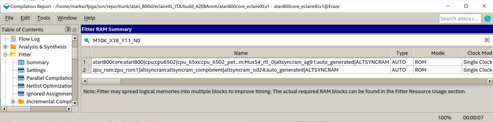

I see the same port of an M10K ram block used in two places. In my most recent build this is M10K_X38_Y11_N0 as seen here in the memory use summary - filtered to the duplicate:

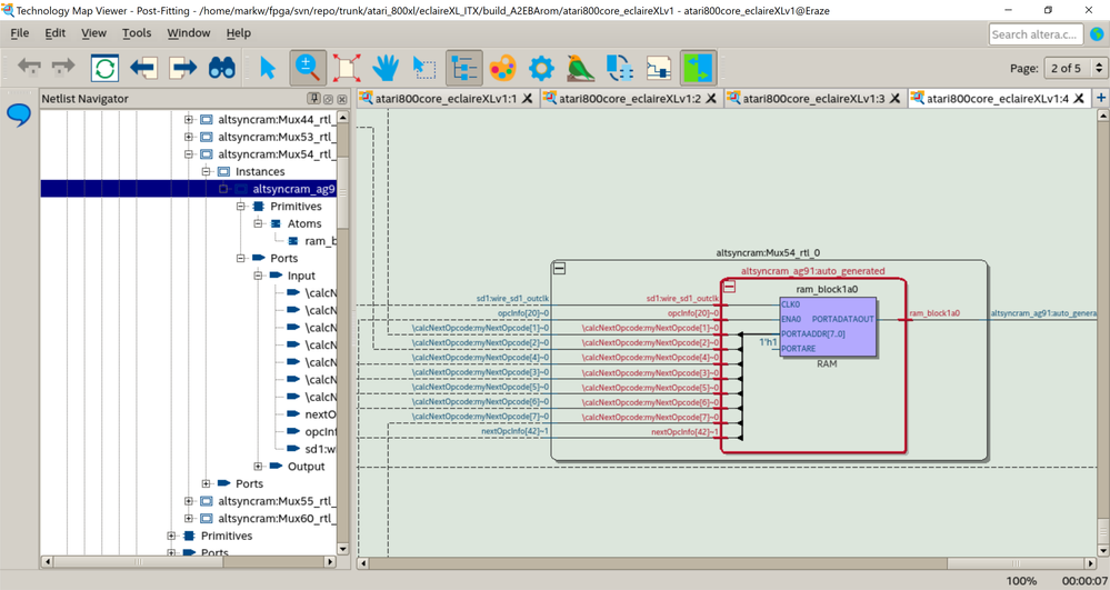

In the technology map viewer I see this in the 6502 cpu:

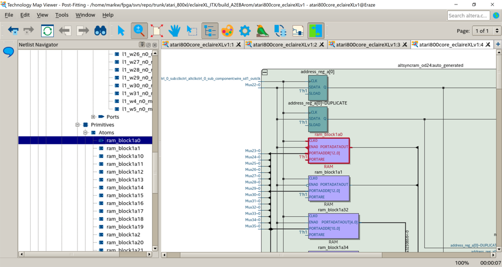

... and the supporting zpu processor rom:
When this occurs I get the wrong results from the op code decoder in the 6502 cpu.
