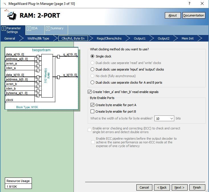

If the width of the data input port is 20, you can only define the size of a byte as 5. In this case, you get a 4-bit byte-enable port.
I was not able to replicate the scenario, byte_en[3:0] which is 4 bit after selecting M10K, true dual-port, set q_a width to 20 bits Please check the image attached..

this was my first post to this forum and I didn't know I can post images. So here is what I do, step by step:

Hi piotr,
I got the problem,
while setting 2-port ram the option " what is the width of a byte for byte enable?" drop down box by default have 10 bits selected, if we click on next we get this error.
So just select 5 bit and reselect the 10 bit will eliminate the error.
We can see correct byteena_a width.
