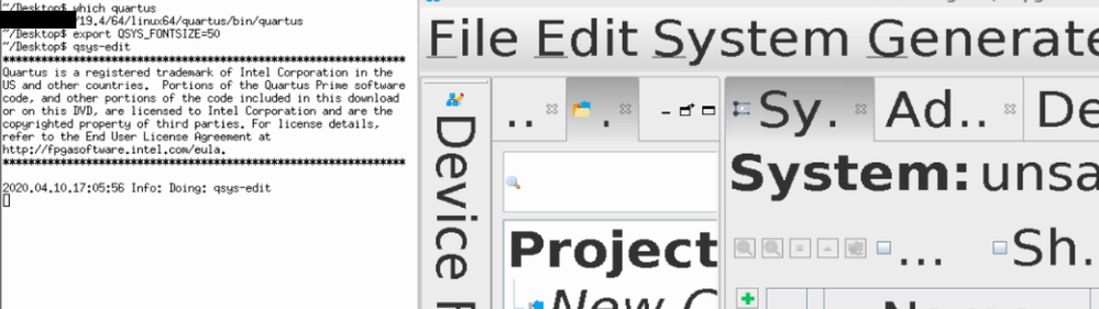

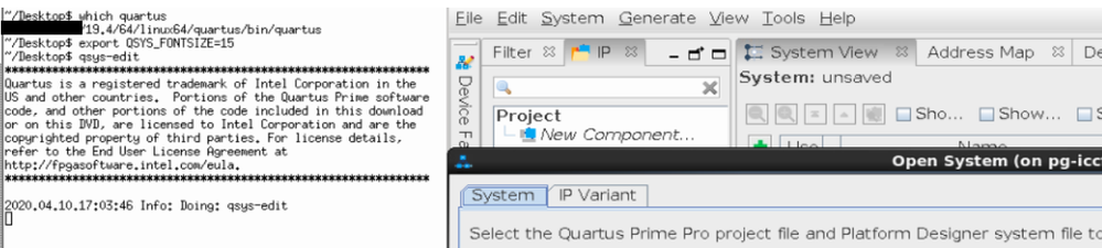

I tried to change the QSYS_FONTSIZE using Pro 19.4. The setting is working, you may see the scrrenshot below.. Have you tried using other monitor?
Font Size 15
Font Size 50
