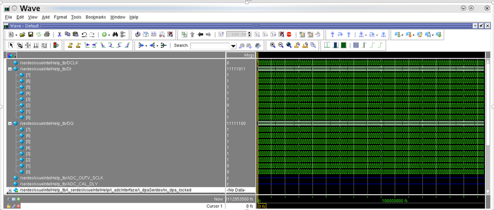

As stated in my first comment, DPA lock does NOT go high EVER, not at the beginning and still not after 4 us simulation time.
Have you run the simulation I provided at all? The reason I provided it was so you can re-create the issue on your end and help. You can see the issue described clearly in there.
I have already reviewed the LVDS SERDES IP Guide and am following the design recommendations.
Attached is a screenshot of my simulation that shows that non of the serdes channels ever get DPA lock even though the data lines are all constantly toggling.
If you can PLEASE take a look at the simulation and help me understand why DPA lock never happens I would greatly appreciate it.
I have also attached the result of running generate example design hoping this helps.
Thank you!

I understand your frustration and I appreciate your patience. I have looked on your design and I found that there is no data on your DPA SERDES. I would advise you to follow the step on this video: https://www.youtube.com/watch?v=rvAByFs4G7c and let me know if you still run the same issue.

Thanks Amin! I have created the simulation from the example design. In that simulation DPA lock does happen but I can not figure out what the difference is to my simulation that does not get DPA lock.
You said you found there is no data on my DPA SERDES. I don't understand. The screenshot you attached shows that the data inputs are all toggling. Why do you say there is no data? I have changed the data input to match the example design simulations data input (input data high for 1 clock then low for 3 clocks and the data being offset by 90 degree phase from the inclock) but I am still not getting DPA lock in my simulation.
