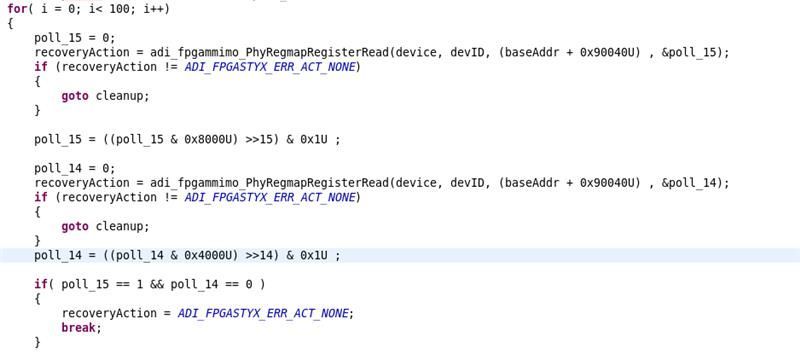

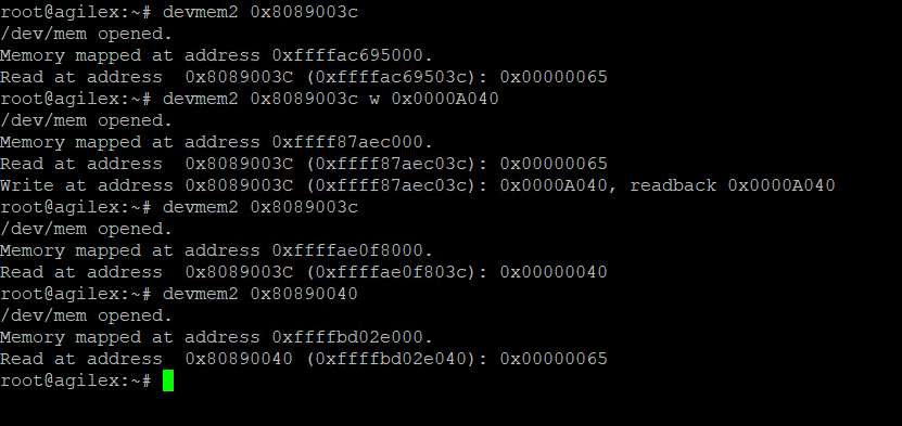

Brief description of the code snippets attached:
- Register write to address 0x9003C
- Register read from address 0x90040
- Regardless of the register writes, we always receive the readdata as 0x65

The address 0x9003C and 0x90040 you're trying are not valid for the IP. Unfortunately, XCVR reconfiguration is not supported in JESD204C IP.
