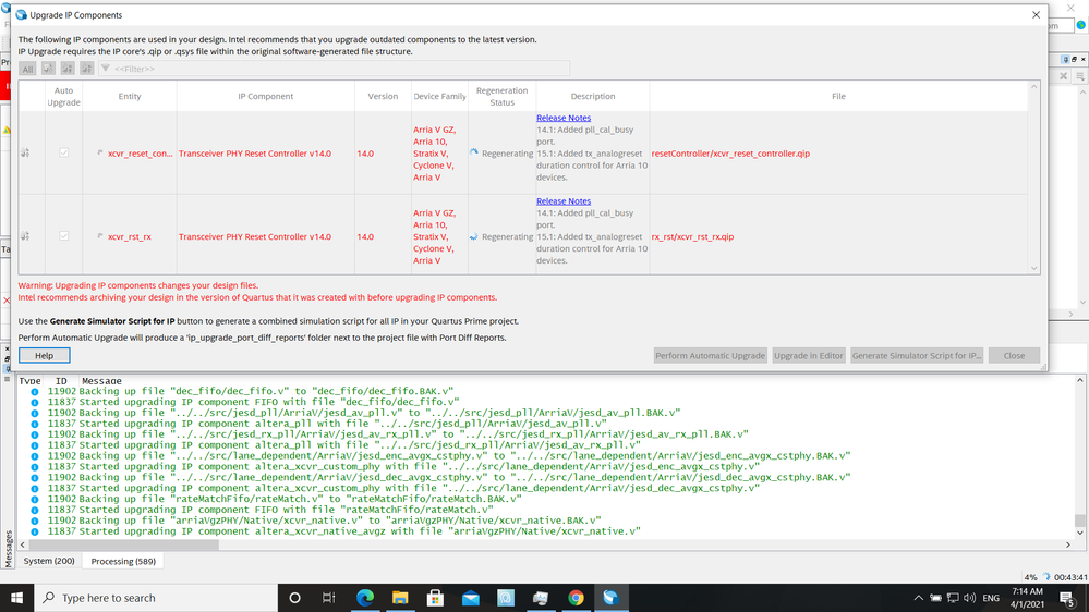

Thank you for your kind reply, I am working on a project that uses the Texas Instruments TSW14J56 evaluation board, with an ArriaV 5AGZME1EH29(ON schematic).When I open the Qar file provided by TI, the latest Quartus Prime Standard Edition(20.1.1) saidWarning (13177): Your design targets the device family "Arria V GZ". The specified family is not a valid device family, is not installed, or is not supported in this version of the Quartus Prime software. If you restored a project from an archived version, your project was successfully restored, but you still must specify or install a supported device family.when I run to install the device, it says Arria V has been installed. ( attached the screen capture)I don't think I can change the device to compile the Qar file, because it is installed on the demo board.please give me suggestions to solve this problem,I used to be a loyal Altera user for many years but didn't use it in recent years.appreciate your help.DavidInfo: Running Quartus Prime Shell

Info: Total CPU time (on all processors): 00:00:12I notice that there is a reminder to update the IP components.I clicked it and choose the automatic upgrade,the process will stick at 4% forever.assume after upgrade the IP, the Quartus can handle the "Arria V GZ". I need some help to complete the IP upgrading process.Thank you- dsun015 years ago
Contributor
Sorry, the picture is wrong, here is the IP upgrade stuck to 4% screen capture.
