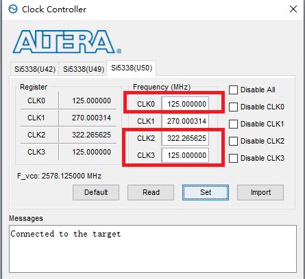

6 years agoINtel Design Store "A10SOC Scalable Multispeed 10M-10G Ethernet Design" fails to test in system console ?
Hello, I have an A10SOC Kit Board. IN intel design store, I found a Multiple - Rate 10GE design example on A10SOC Kit Brd as below link : https://fpgacloud.intel.com/devstore/platform/16.0.0...
- 6 years ago
after following the design user guide ( https://www.intel.com/content/dam/altera-www/global/en_US/uploads/3/38/Arria_10_SOC_Scalable_Multispeed_10M-10G_Ethernet_Design_user_guide.pdf ),
to set " U50 CLK0A/B = 100MHz for "mm_clk" input ", the System Console can work as expect, I can run test using this example design on A10SOC KIT Board,
Thanks all for helps.
