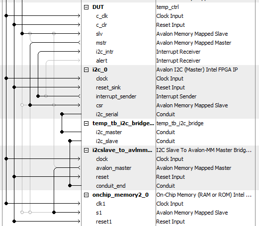

I am using the Intel I2C Master IP Core to communicate with a temperature sensor (TMP75B) on a custom PCB including an Arria 10 GX FPGA. The hardware is not yet present therefore I am currently simulating the components with ModelSim.
The Qsys subsystem under test includes the I2C Master IP Core, my custom VHDL component that interacts with it and the Intel I2C Slave IP Core together with a On-Chip RAM for test purposes. In hardware the I2C Slave and the RAM will be replaced by the temperature sensor.
The subsystem also includes a I2C bridge, that connects the SDA and SCL pins via pull-up logic.

As you can see in the image above, the master does send the Start+Address=5+Write (red), the Stop+Register=0 (purple) and then the Start+Address=5+Read (green). The master then receives the first data byte (0x34) from the slave (orange).
But after receiving the first data byte the I2C master doesn't generate a 9th clock with an ACK and the transmission of the second data byte is not started.
Does anybody know why the I2C Master behaves this way or what I am doing wrong?

Hi Florian,
Check this previous KDB https://www.intel.com/content/www/us/en/support/programmable/articles/000086390.html.
You can't observe the ACK signal from simulation is expected as the ACK and NACK is handled by the controller itself.
However, you can use NACK_DET to check in case of master write to slave so that you'll know whenever there is no acknowledgement from slave. Hope it helps.

Hi Sheng,
thanks for the quick answer!
I have found that KDB when looking for a solution, but I thought it said that I could not control the ACK and NACK of the I2C Master IP core manually. Seems like I misinterpreted it.It's a pity that I am now not able to simulate the I2C interface, but I guess I'll have to wait for the hardware and test through SignalTap then.
