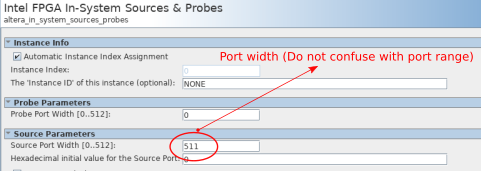

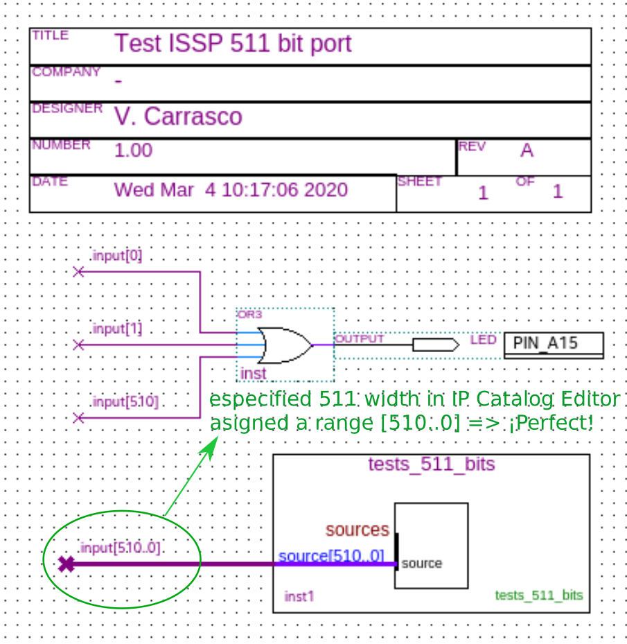

I have performed the following tests:
CASE OK: an In-System source of 511 bits wide its range should be [0..510]:
IP Catalalog -> [...] -> Altera In-System Sources & Probes.
Insert the IP variation into a test design and add some simple logic:
Results:
Analysis & Elaboration → OK!
Analysis & Synthesis → OK!
Compitation → OK!
Programation in FPGA → OK! (Family: Cyclone IV E Device: EP4CE22F17C6 )
Test hardware In-System Sources & Probes Editor → OK!
Test hardware via TCL scripting → OK!

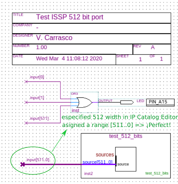

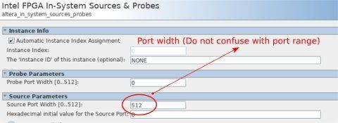

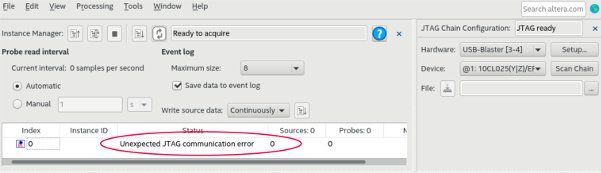

CASE KO:
Now I am going to create a 512-bit wide In-System source, its range should be [0.511].
Results:
Compitation → OK!

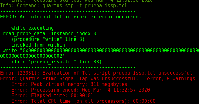

Test hardware In-System Sources & Probes Editor → KO!
Test hardware via TCL scripting → KO!
←End test cases

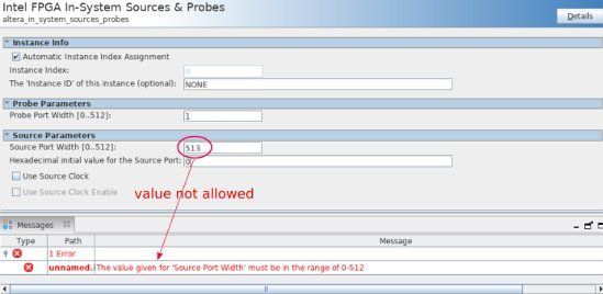

I think I am making proper use of the Quartus tools, for example IP Catalog Editor makes sure to validate the entries for example:
I may be wrong but it seems to me that the origin of these problems may be in the archive altsource_probe_top.v. But this file is owned by (C) 2001-2019 Intel Corporation and the terms of the license prohibit any modification.
- RichardT_altera6 years ago
The unexpected JTAG communication error can occur because the board is not powered on, the programming hardware is not connected, there is a problem with the circuit board, or you did not SRAM Object File (.sof).
Make sure the circuit board is powered on, the programming hardware is connected properly, and download the current SOF.
