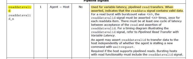

how to use valid signal with readdata in Avalon Memory Mapped Interface
How can I make sure that the incoming data from memory is the response to memory read request and is also valid?
I am using Avalon Memory-Mapped Interface and I want to get a valid signal for each data that I request from memory by a readdata request.

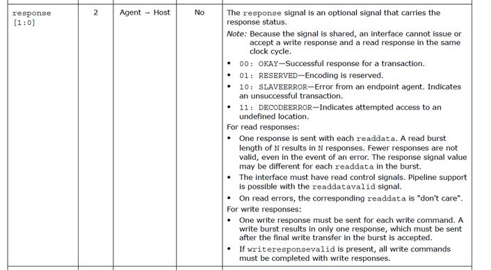

Can I use this condition: (response == 0)? Does it arrive at the same clock that data arrives?
Note that I am using a fixed-latency read, so I am not able to use readdatavalid signal.

  • Yes, a response of 0x0 can be sent along with valid readdata. Check the info "For read responses" in that table.
  • sstrell's avatar
    sstrell
