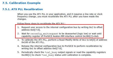

As I understand it, you have some inquiries related to the C10GX XCVR recalibration. As I understand it, after you write 0x2 to address 0x0 to request for the AVMM bus access, the waitrequest signal seems stuck at High in Modelsim simulation. Just would like to check with you if you have had a chance to try reading register 0x281[2] to see if the value return 0? Just to narrow down if it is waitrequest signal bug in simulation.
Alternatively, you may proceed to perform the user recalibration some time after requesting for AVMM bus access to see if calibration can be kicked start. Again, just to narrow down if it is waitrequest signal bug in simulation.
Please let me know if there is any concern. Thank you.
