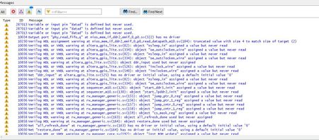

6 years agoHow to handle such warning message of UniPHY IP
Use DDR2 controller with UniPHY Integerate in platform design with NIOS. Device used: Max10, 10M16DCU324I7G Start analysis & Synthesis How to handle below warmings?

It seems to be a variable declaration issue and connectivity issue. I am suspecting this attributed to the warning.
Can the fitter compilation complete without error?-- If Fitter is Passing without error, then you can safely ignore the synthesis warnings.
You may find it useful to run the example design first, check the connection to help understanding and compare with your design.
I am attaching a word document which I centralized all the warnings listed with “CAUSE” and “ACTION” to help handle the warnings.
