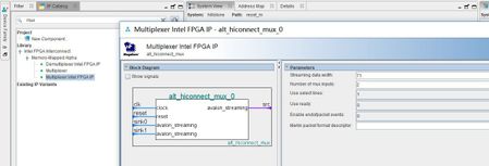

6 years agohow can we get the hdl source code of platform design ip
such as multiplex ip, we can find it in install directory. our end customer would not like to use qsys or platform designner how can we get these ipcores source code?

6 years agoI See, when we finish to generate the system ,we can get the source code.
But what I mean is before you generate the system, we only can find the tcl script in installation folder, can not find the source code, how can we do?
We don’t like to use Qsys or platform designer tools. We only instant the entity with the source code would be ok.
Such as the module what I notice yesterday, I can find its source in folder.
