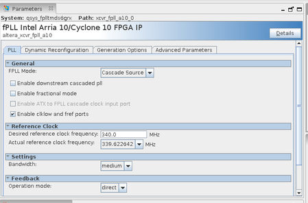

Currently our design (using 10AX115) is suffering a HDMI compatibility issue with a certain video source. The HDMI Rx is Coretronix's in-house IP. The Tx is a specific video box. We already know tha...
