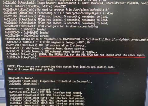

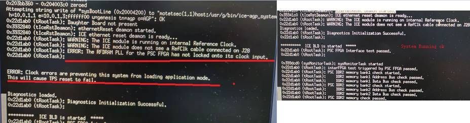

need sent sample to Internal perform FA, test Fail 7 pcs, D/C:2125(total 96pcs),The error message is a self-check error reported during system startup (Error and normal as shown below). The external 80M reference clock is normal,

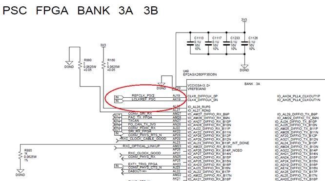

根据系统报错提示和debug guide分析,我们测量了从J28过来的参考时钟(REFCLK_PSC) 80 M 正常。查看FPGA U49 的焊点正常,reflow U49无效,更换U49系统恢复正常
