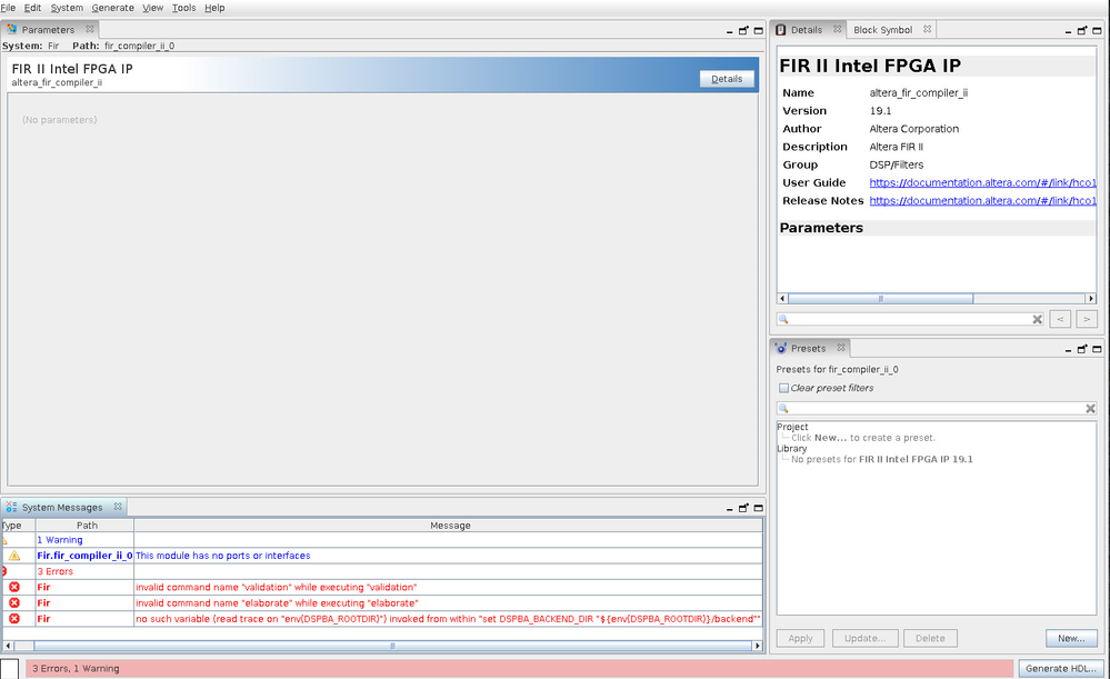

thanks for your update. As I understand it from the error message, it seems to related to environment variable settings. Can you try the following:
1. In Linux, try
export DSPBA_ROOTDIR=$QUARTUS_ROOTDIR/dspba
or
setenv DSPBA_ROOTDIR $QUARTUS_ROOTDIR/dspba
2. In Windows, try set the above path in Environment Variables
Please let me know if there is any concern. Thank you.

Sorry if there is any confusion. As I checked with my Q20.3Pro, I am able to see FIR II Intel FPGA IP for Agilex device. To ensure we are on the same page, would you mind to further elaborate on your observation?
Thank you.

I can see FIR II Intel FPGA IP for Agilex in Quartus 20.3 in IP catalog. But I'm not able to generate or Upgrade. Tool sends out following error message.
