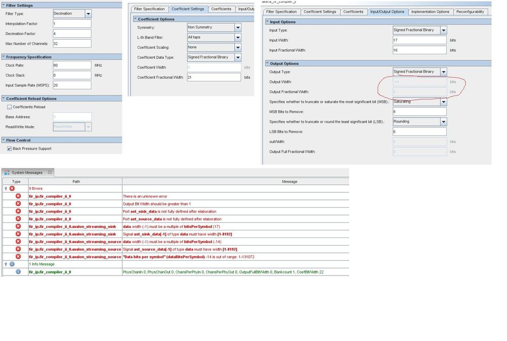

4 years agoFIR II core IP of quartus prime pro can generate a valid instance
the same parameter did not report the following error info when I use quartus prime 18.1 and quartus prime pro19.4, but when I use quartus prime pro 22.1 ,the output bit width is <0 , who can help me?
