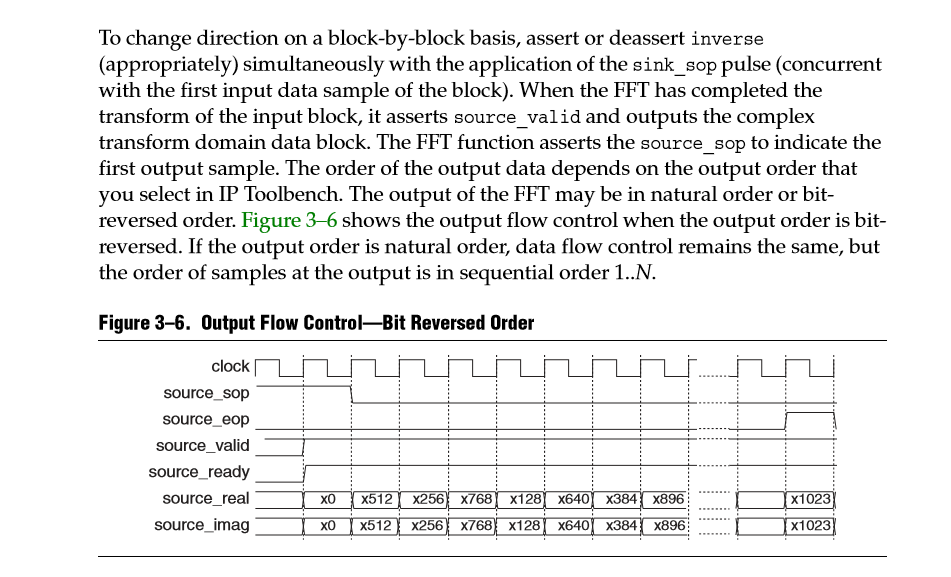

My idea is whether it is possible to use only one module to realize FFT and IFFT operations, so I only use one IP core to do the following test,
According to FFT data manual, FFT operation is performed on 64-point sinusoidal data, and the inverse is equal to 0;Then wait for FFT to output the data, and send the output data source_real and source_imag into the same module for IFFT operation, at which time inverse=1.But the source_valid timing, source_real and source_imag seem to be wrong.

As you said, it will work just fine.However, because my design needs too many resources to use two modules to implement FFT and IFFT, I consider using a single module to implement FFT and IFFT.Using a single module to implement FFT and IFFT is, in my opinion, the same as the continuous input data into the FFT module, only the inverse signal changes.I think the output sequence is as follows,
Is that not a viable idea?Thank you.

Hi, For your information, the figure 3-7 is showing that the FFT would only process data when valid = 1, it will pause and wait for subsequent frame to come in and will continue when valid = 1 again. It is still for the same data stream. So, you will need to complete a input with SOP and EOP before you switch to another mode. As for the inverse signal, for your information, it is only sample simultaneously with SOP assertion. In other words, after the FFT completed the processing of the 1st data stream and output completed, then you can switch to iFFT and input new set of data. Based on my understanding, the FFT simulation model the functional behavior. If you are seeing issue with a specific setup, generally you would observe similar behavior in hardware. Please let me know if there is any concern. Thank you. Best regards, Chee Pin - 志姜0006 years ago
Thanks for your help, I have another question, change the inverse processing direction, which means after the FFT transformation, wait until all the data is out before you can change the inverse direction?My understanding should be that the next sink_sop assertion can be changed, if so, then my idea should be achievable;If I don't understand that, as you said, I need to wait for all the FFT data to be output before I can change the direction of the inverse, then I will do what you said.

Hi, Since you are switching the FFT mode, my understanding is we should wait for the FFT to complete outputting the data before we switch to iFFT. This is to avoid corrupting the FFT operation half way. Can you try to see if it works this way in simulation? Please let me know if there is any concern. Thank you. Best regards, Chee Pin - 志姜0006 years ago
