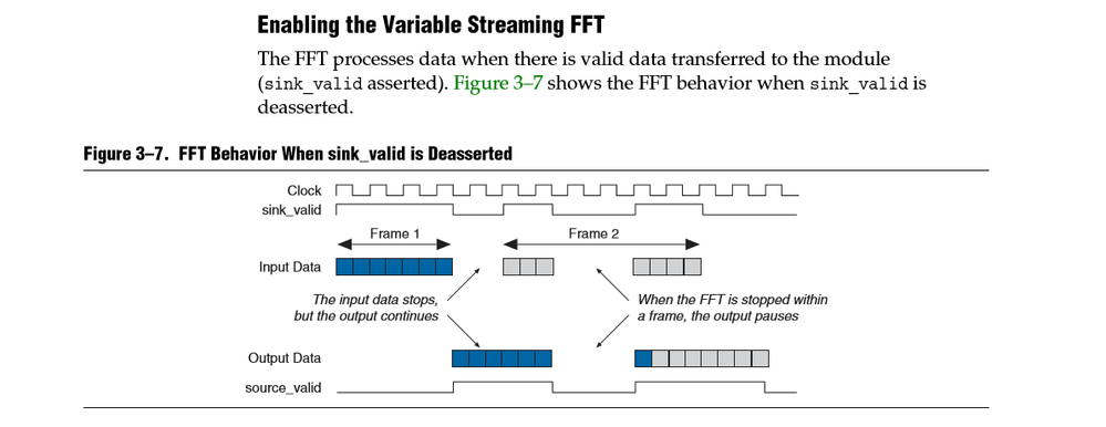

As you said, it will work just fine.However, because my design needs too many resources to use two modules to implement FFT and IFFT, I consider using a single module to implement FFT and IFFT.Using a single module to implement FFT and IFFT is, in my opinion, the same as the continuous input data into the FFT module, only the inverse signal changes.I think the output sequence is as follows,
Is that not a viable idea?Thank you.
- CheepinC_altera6 years ago
Hi, For your information, the figure 3-7 is showing that the FFT would only process data when valid = 1, it will pause and wait for subsequent frame to come in and will continue when valid = 1 again. It is still for the same data stream. So, you will need to complete a input with SOP and EOP before you switch to another mode. As for the inverse signal, for your information, it is only sample simultaneously with SOP assertion. In other words, after the FFT completed the processing of the 1st data stream and output completed, then you can switch to iFFT and input new set of data. Based on my understanding, the FFT simulation model the functional behavior. If you are seeing issue with a specific setup, generally you would observe similar behavior in hardware. Please let me know if there is any concern. Thank you. Best regards, Chee Pin
