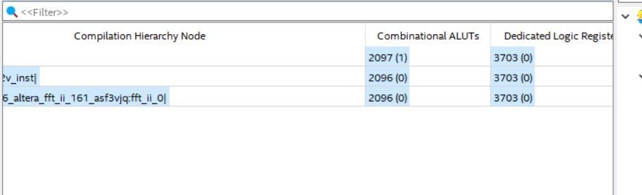

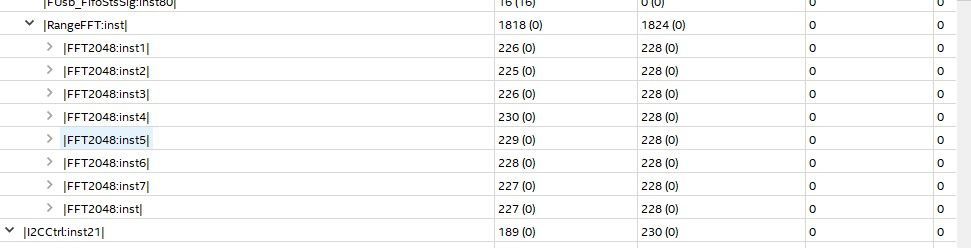

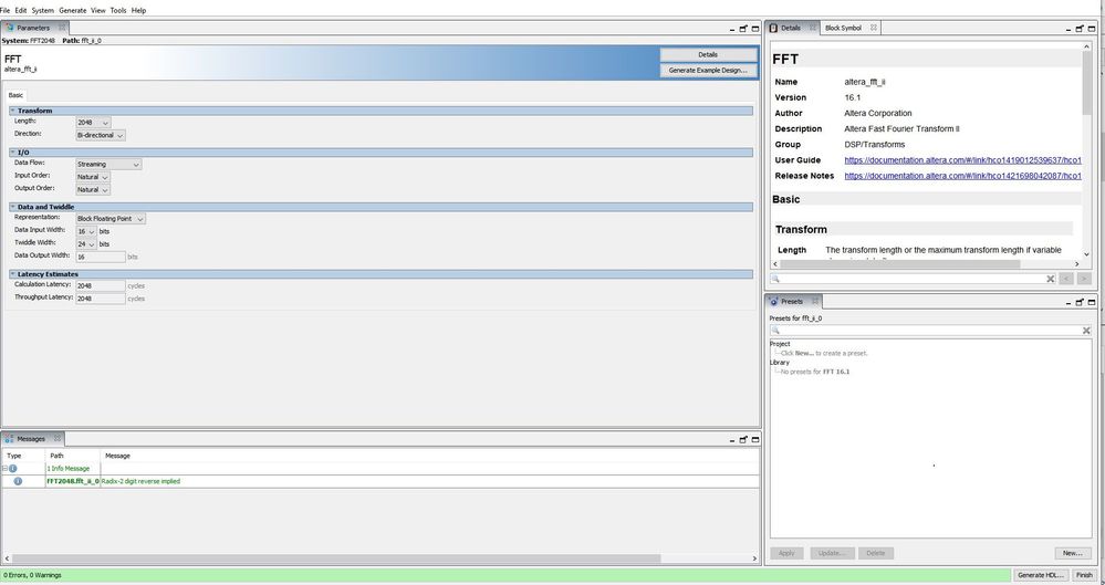

I have two projects where in each I instantiated FFT 2048 IP bidirectional Block floating point configuration and rest is also same in both but in one project it's taking around 2k alm where as in other it's taking only around 226 alms. can you explain why this kind of things can happen generally.
Project 1
Project 2
IP settings
