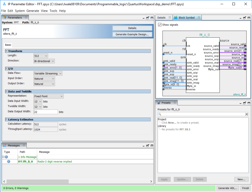

I've configure the FFT for fixed point representation, have given lots of extra bits to the output for bit grow (12 bits in, 22 bits out) and have no error flags with all ready/valid outputs working as expected.

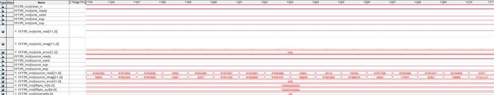

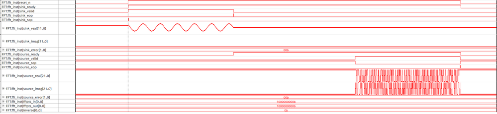

But despite a reasonably clean sine input signal, my FFT outputs either near maximum or near minimum out put value seemingly at random (data in and out of the FFT displayed as unsigned line chart).
The output of the FFT always looks different every time, but always just contains a seemingly random array of near min and near max values.
The input is a 1Khz sine wave sampled at approximately 83KHz
