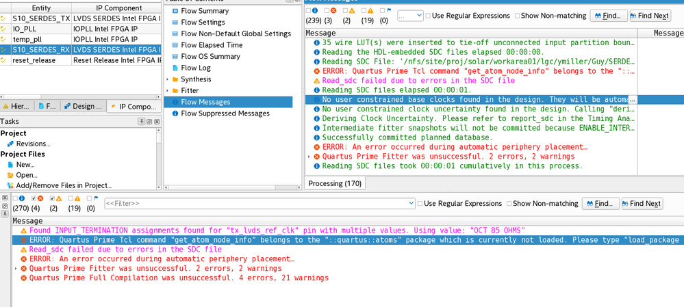

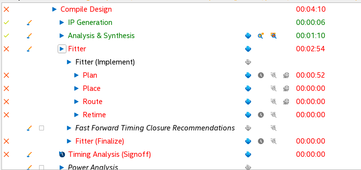

The error occure in the middle of plan stage
Attach screenshot :

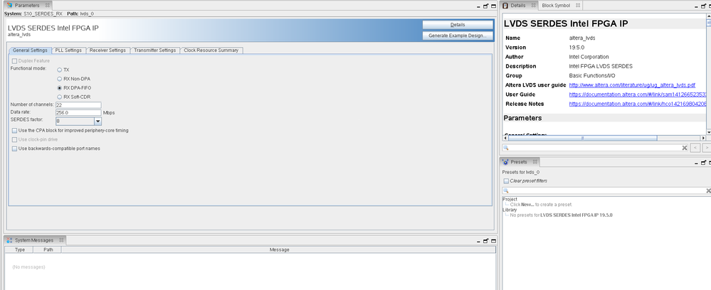

I have the LVDS SERDES IP in my project -My change was defintion in the IP GUI to get clock from external PLL instead of internal PLL
There are no errors/warnings in the GUI editor when I try to regenerae
Attached screenshot :
