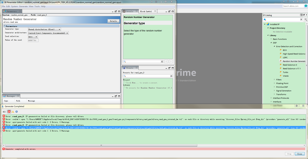

ERROR in generatoring Random Number Generator IP
Quartus prime standard version 17.1 is used. The FPGA used is the Stratix IV family. When generating the random number generator IP core, the following error occurs.
Error: rand_gen_0: IP geneneration failed at file discovery, please tell Altera
Error: couldn't open "C:/Users/ADMINI~1/AppData/Local/Temp/alt8142_9067140267533821730.dir/0002_rand_gen_0_gen//rand_gen.prj/components/altera_rand_gen/altera_rand_gen_internal_hw.tcl": no such file or directory
While executing
"discover_files $proxy_file_set $tmp_dir"
(procedure "generate_all" line 16)
Invoke from within
"generate_all $output_name SIM_VERILOG "
(procedure "generate_sim_verilog" line 2)
Invoke from within
"generate_sim_verilog random_normal_gen_rand_gen_0"
Error: qsys-generate failed with exit code 1: 2 Errors, 0 Warnings
Error: couldn't open "C:/Users/ADMINI~1/AppData/Local/Temp/alt8142_9067140267533821730.dir/0004_rand_gen_0_gen//rand_gen.prj/components/altera_rand_gen/altera_rand_gen_internal_hw.tcl": no such file or directory
While executing
Invoke from within
"generate_all $output_name QUARTUS_SYNTH"
(procedure "generate_quartus_synth" line 2)
Invoke from within
"generate_quartus_synth random_normal_gen_rand_gen_0"
