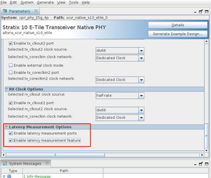

Hi,Leo
Thanks for your help.
We are using the stratix 10 E-tile Transceiver Native phy ip core, and we have enabled latency measurement options.
but for this ip(stratix 10 E-tile Transceiver Native phy ip )the reconfig_readdata is 8-bit per channel.
I used four channels,so the reconfig_readdata is 32-bits.
Because we want to use latency measurement.
