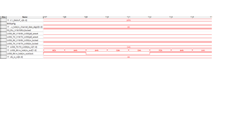

7 years agoDear RSree,
Now I am having rx_clock and tx_clock pins are locked high now. I went to check with oscilloscope for the LVDS transmitter output clock tx_outclock but this is not being generated.
Why tx_outclock is not being generated?
