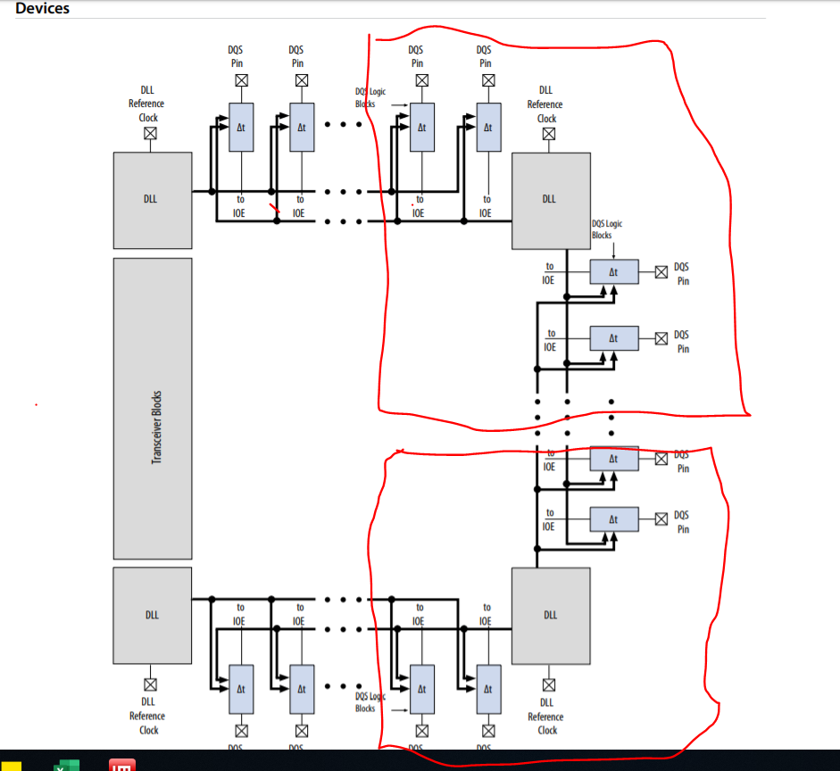

To minimize the use of PLL, we decided to use PLL Sharing, but Fitter swears at the impossibility of placing the DLL. I did not find any examples on the Internet

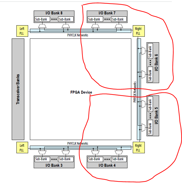

    I can see that your design contained Hard memory controller (HMC) which is fixed at Bank 7A and 4A for Cyclone V C7 device. Unfortunately, for HMC there is no sharing allowed for DLL due to its architecture. So, the fitter error seen is expected.
    As shown in diagram below, you can see that the DLLs can access the two adjacent sides from its location in the device or in other word Bank 7 and Bank 6 for top DLL and Bank 5 and Bank 4 for bottom DLL . Since, the HMC is fixed at Bank 7A and Bank 4A, so there is no way to share the DLL.

    Dear EBoln,
    Thank you for joining this Intel Community. I am sorry for the delay in response as I were out of office due to medical leave.
