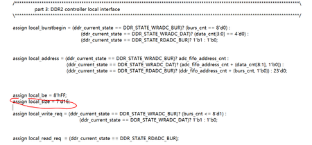

4 years agoburst read and write DDR2 using altmemphy
1) Need forum admin to help, I can not post any reply on below topic.
2) answer to this topic:
I also attached code for you in the link.
3) correct one information, ddr2 ram is MT47H...
AdzimZM_Altera
4 years agoHello,
According to the user guide, you can set the local_size either 2 or 1.
