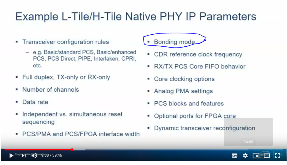

- HBhat27 years ago
Contributor
Hi @NathanR_Intel ,
https://www.youtube.com/watch?v=PxAx_xR_iJA
In this training video "Building an Intel® Stratix® 10 FPGA Transceiver PHY Layer", the material says that Bonding mode can be configured for L tile / H-tile XCVR PHY.
With Regards,
