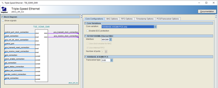

1 year agoArria V from TSE to 2.5G
A system is currently using an Arria V with the Triple Speed Ethernet IP in PCS only configuration. The design is successfully communicating with other SGMII capable devices at 10/100/1000 speeds. ...
paveetirrasrie_Altera
1 year agoYes it can be done but we have not validated it.
What I would suggest is if you want to support both backplane 2.5G and standard 10/100/1000M, you may use TSE IP for SGMII interface and use transceiver PHY IP for 2.5G SGMII/1000Base-X and add control logic to switch interfaces based on detected link type.
