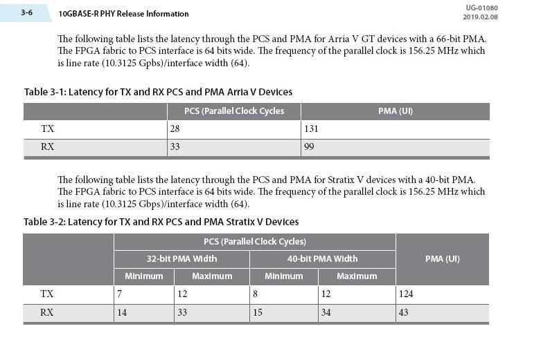

Arria 10 Transceiver Native Phy PMA Latency
I find Pma Latency of Stratix V and Arria V in "V-Series Transceiver PHY IP Core User Guide".
Where can I find Pma Latency for Arria 10?

    As I understand it, you are looking for the PMA latency information for A10 devices. As I search through the user guide and datasheet, seems like there is no specific information on this. As a workaround, it is recommended for you to run through simulation to estimate your latency for your specific XCVR configuration. Sorry for the inconvenience.
