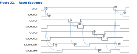

Agilex7 F-TILE ethernet hard IP 200G
Now  we develop a project with agilex7 fpga.  In the project we generate 200Gx4 ethernet hard ip.  during testing on-board,  the reset flow of the ethernet IP  failed to complete successfully: The ...

    Based on the status signals shared:
    * tx_lanes_stable = 0
    * sys_pll_locked = 0
    * tx_pll_locked = 1
    the issue is most likely related to the system PLL/reference clock domain not achieving lock, which prevents the F-Tile Ethernet Hard IP reset sequence from progressing successfully.
    Since `sys_pll_locked` remains deasserted, the internal reset controller continues to hold the IP in reset. As a result:
    * `o_rst_ack_n / o_tx_rst_ack_n / o_rx_rst_ack_n` remain High,
    * `i_rst_n / i_tx_rst_n / i_rx_rst_n` stay asserted Low,
    * and `tx_lanes_stable` never transitions to 1.
    The fact that `tx_pll_locked = 1` indicates that the TX PLL itself is operational, while the system PLL domain required for PCS/reset sequencing is not locking properly.
