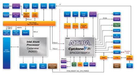

Hi all, I am currently working on a hardware project thatruns on DE2i-150. Hope there is anyone can help me on my problems written below. I would like to access the SODIMM DDR3 module on the boar...

Hi Sir,
From the diagram, the DDR3 SODIMM seem like is direct connect to ATOM processor without pass through the FPGA. Therefore, no FPGA design is need here to let the ATOM processor to access the DDR3. Also, this is not Intel PSG (Altera) board, but it is Terasic board, please contact Terasic for further support.
