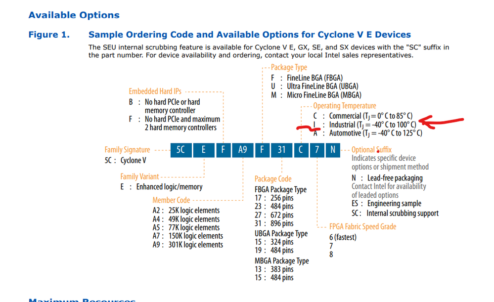

The operating temperature of device that you use is industrial mode which can support from -40° C to 100° C. For further details, you may refer to the link below, https://www.intel.com/content/www/us/en/docs/programmable/683694/current/device-variants-and-packages.html
zying
- JLIU45
OK, so I think this problem should not related to FPGA, maybe caused by other components, e.g. PHY...
